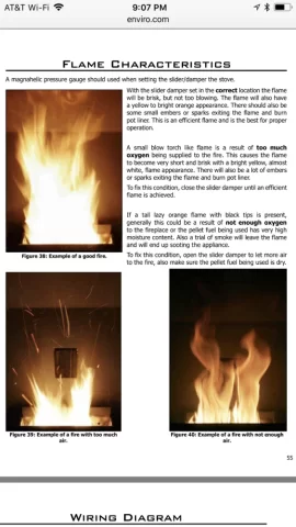

Also i have great heat coming from the stove but there does seem to be a lot of ash after 24hrs and when the stove is running the flame is yellow to orange and not lazy i dont think.
When the pellets drop in it seems to blow out peices of pellets that are still burning? Is this what you call fly ash?

Your door glass gasket should have a gap on the bottom for the air wash meaning no gasket material so cut it all out. The amount of ash is probably pellet brand or just a bad batch. The burning embers flying around ( we call fire flies ) are normal as long as it isn’t really large pieces. Here is a good reference for you flame
  • [Hearth.com] King kp130
