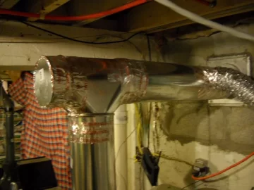

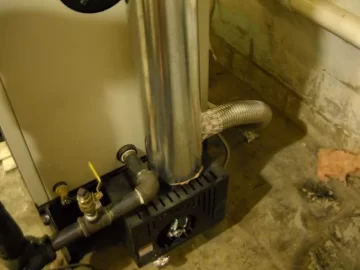

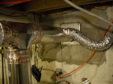

My cap leaked too. I tried to seal it with tape but on rainy days (not sure what that has to do with it) it seemed so bother with a slight smell upstairs. I solved the problem when I installed a fresh air kit....I put a 6 inch pipe over my entire 4 inch vent pipe and channeled the outside air around between the pipes to preheat the outside air. now anything that leaks is drawn into the stove. pictures to follow

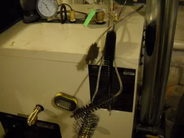

Here are some pictures and pictures of the boiler brushes i use
  • [Hearth.com] Leaking Exhaust pipe, clinkers, smokey smell
