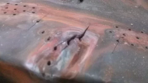

Then there was last year: Gas flames changed, sometimes more blue, some lifting sometimes. Then suddenly no gas. Supplier replaced regulators in the line. After pressure test, I noticed my burner was *warped and cracked* from the pilot flame area (I'd say, big-time, see photo)!! No explanation as to why from the pros. So, I blithely began the quixotic quest for parts, which took 5 + months and hundreds of dollars and drama. New blower assembly (needed anyway), new burner, new pilot assembly (for good measure). Professional re-assembly with some DIY from me on the blower.

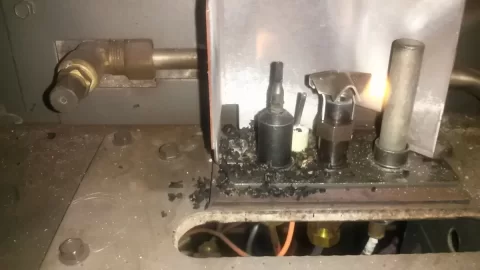

It was working some last week, but now it's colder. No ignition. Just pilot. AND something new and very odd: sooty particles adhering to the thermocouple! They build up quick, glow orange, then fall off leaving a nice little pile below. See photo. Never seen such as this- I'd say impurities in the gas coming through the pilot?!?
This is the derndest thing- no gas smell, thermostadt is clicking fine to the valve, air shutter looks nice and clear. Do I have some defective gas? Or low gas pressure? Plenty of fresh air around, top vented, closed/covered pro chimney liner-- or did the service guy not give full service and cleaning?
I guess my mind is blown as to what could be going on. I feel the hot gas or high pressure, or *something* caused my nice old burner to glow up and warp/crack, and perhaps the original problem isn't solved.
