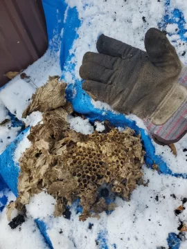

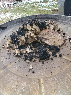

I have always covered my Central Boiler chimney over the summer months (since 2010), but I got lazy last spring and let it go. Yesterday I could not get a fire to start, just a faint wisp of smoke from the chimney. When I open the door great clouds of smoke escape, telling me my stack is plugged. Now toward the end of last winter I was burning some questionably unseasoned wood, so I assumed I'd creosoted up my chimney. I was planning to rent a tall step ladder and go up to unplug it, but instead tried one last thing - a drain snake. Boy, was I glad I did! We live at the edge of a woods, and wasps had made themselves quite a home up there. Luckily I was able to knock it loose from the bottom cleanout. Whew (sigh of relief). Photos show what came down. Won't neglect to do that again!

View attachment 341965View attachment 341966
