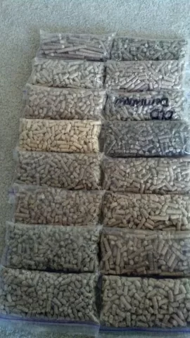

Here are a few specimens ;)

let's raid dexter's stash, i'll lead the charge;)
Reactions: DexterDay
That sample on the top left looks like a bag of pretzel sticks !
yea, those long ones would mean a real low fire on a lower setting for me...hear the auger grind!
