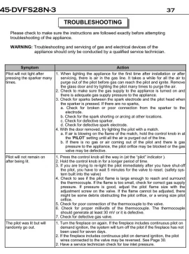

This is from your owner’s manual. Have you bled the gas line?
[Hearth.com] Lighter issue
It's not the gas line, the stove burn properly when I light it with a BBQ lighter.
In this trouble shooting page I don't find my issue.
