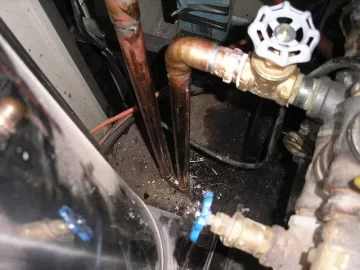

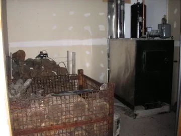

Wondering how much wood you guy's put in these things? I'm on my second year with this thing and so far so good. (other than the dripping creosol out the sides) But One thing I still wonder is how much wood can you put in these things? Can you stack it right to the bottom of the door? One thing I have found is that it is true, if it fits threw the door it burns. Now with that said it dosent seen to produce as much heat with a load of big rounds but it depends what your needs are.

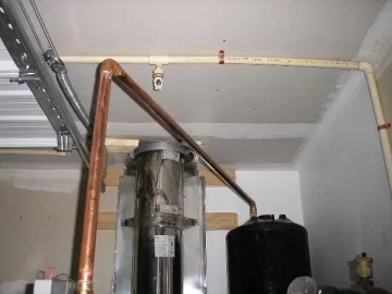

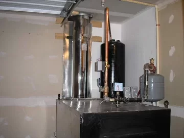

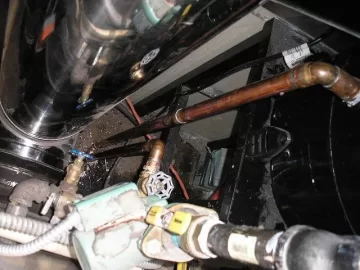

I also thought I'd share my pics of my safety dump. I used a 40 gallon hot water and a normally open valve. On the back (inlet) I put in a heat loop to prevent heating the bottom of the tank. And all in all it works great and was pretty cheap.
The only thing I still want to do is put in a bypass in so I don't get so much tempature drop when my infloor kicks in. But I have a real problem paying over 200 bucks for a danross valve. Does any one out there found a less expensive soulution?

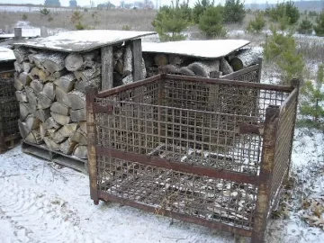

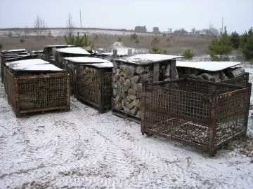

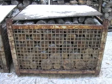

How are you storing your wood in the summer?
I really don't think that over heating would happen. Once the basment floor (Dump Zone) kicks on even with the biggest fire it will take out 20-30 deg on the water temp in less than 3 min. I don't know how to calculate it but a 1800 sq foot slab takes up allot of BTU's.

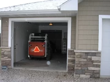

But any way's this is what we do. After the tree is down and cut to lenght we have the splitter on the back of my ATV and bring the spilter right to the tree and split what is needed. The Pallet is on the 3 point of the tractor right next to the splitter. So I split it and stack it directly on to the pallet. And the smaller limbs then get stacked on as well. Then we take the pallets in a open field and cover them with a what ever we can find, plywood car hoods steal siding ect. Then in the fall I load the pallets (24 for this year) onto my trailer and bring them to my house. I take my Bobcat, unload them and stage them in back of my shed and recover. I then built my 3rd stall extra deep for my boiler room. I bring in two pallets with my Bobcat into the boiler room and and chuck in into my stove. I like making wood but all of the handeling that usually goes on is crazy! I only touch my wood twice. Once stacking it onto the pallets and once into the boiler.
Next year I'm building a short pole shed (so to speak) with out any walls for storage. Just high enough for the pallets to fit under.

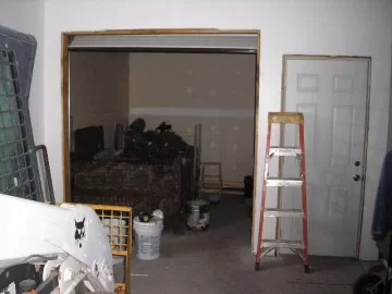

And the one other thing I did was install a sprinker system in the boiler room. Sprinkers go off at 140 deg ( I know that seems low but I got them from a guy who does that for a living) and would contain the fire in the worst case. All of the warter then would flow to the floor drains and viola.

You are asking for it. When my GW overheated three years ago, due to the damper door not closing all the way, it was a big mess. The area around the stove hit 140º easy. The water temp went to 270º screwing all the pex it touched. My 50k dumpzone was overloaded quickly. This all started by burning nice dry hickory splits on a 20º night. GW soon started saying not to burn splits, not that they were or the dealer were any help at all.
I like your wood set up though.

I can't tell by the pictures, do you have temp. and pressure safety blow offs?
That would be Yes the unit came with both a pressure and Temp blow off. on the back of the unit.

Very good............Also, I am very envious of your wood handling program...........that's awesome.
I cut logs into lumber for a living. I have cut plenty of logs that sat for 5 years. I found plenty of moisture in those logs as seen by how the wood cuts and by moisture meter readings.
I think it is likely that unless you kiln dry your rounds you are likely burning green wood.
