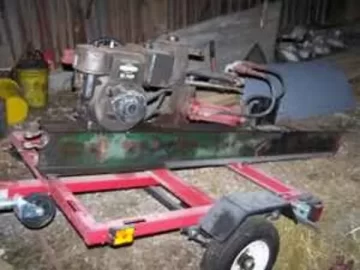

Mine started as a 3 point. here is a good trailer option. Im putting down extanded metal for the floor and raising the beam up on 10 inch "I" beam sections and will hinge it at the back for vertical applications.

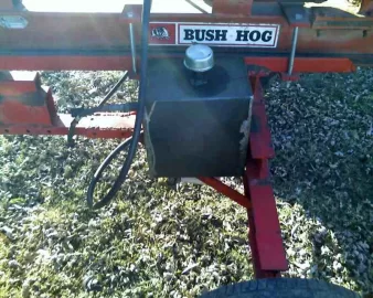

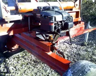

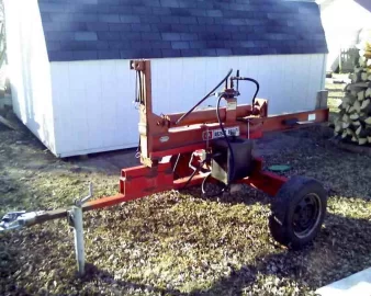

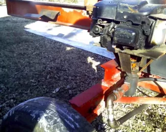

Ok here are the photos I promised.
The shop class turned the splitter around so that I could move it away from split stack easier and cut off the horizontal arms of the 3pt hitch.
They made the oil tank.
They also made the plate that the motor mounts on and the bracket the pump mounts to as well.
The splitter has a 36" long ram and in the future I want to update it with a shorter but larger diameter one, a bigger electric start engine, a larger pump and a log lift and catcher table on the end.
