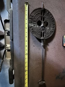

Damper was spinning some on the rod and not holding, but I flipped damper over and am using the other side that holds the curved part of the rod and it seems to be holding better for now. Guess I could put a little stove cement to hold it in place if need be in the future. Other issue is it will be in the open position and at times while putting more wood into the stove and will automatically turn to the closed position straight up and down. Sometimes you hear it move, but of course smoke starts coming out the front door immediately.

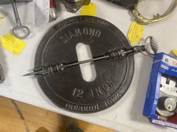

Could it be a rod from a 12” damper that someone put on an 8”?
[Hearth.com] Long handled in pipe damper
I don't think so, the bumps in the rod wouldn't align correctly with the 8" plate.

The way you have it displayed in the picture, the damper can not spin on the rod. If you had the “horseshoe” away from the cast recess before you adjusted it, it would flop around about 180degrees. Now it cannot. The spring should hold tension against the pipe wall. Sounds like the spring is shot.
