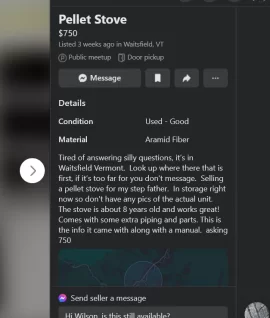

This guy has the Classic Bay 1200 for $1000 less a couple of hours North in Vermont. In storage,selling for a relative. He sounds agravated by stupid questions and it's been up three weeks. Probable get it cheaper just so he doesn't have to answer any more questions.
