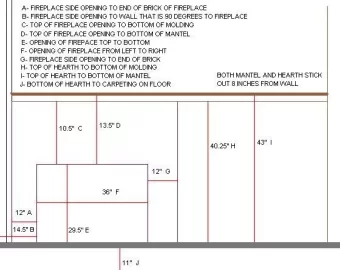

Looking for a quality wood insert for my fireplace... attached are measurments for my setbacks.
hydrasports
Dec 8, 2011
6
Eastern Ct
Here is my issue... I am looking for a good quality fireplace insert (wood) for my home. My problem is that my mantel is pretty low and I have a perpendicular wall that is close to the fireplace. My fireplace is pretty good size so I want to get the biggest one I can yet stay within what the building inspector will adhere to; which is what the insert manufacture info states.
Most of what I looked at says the wall is too close and also the mantel is too close. I liked the quadrafire Voyager but I am 3/4 of an inch too close to the wall and the mantel is still too low.
I will probably have to sell the mantel deflector to the building inspector so I would like to find one that can be installed for the winter and yet uninstalled for the summer when not in use.
Any help would be greatly appreciated.

My opening is about the same as yours - 25" high x 38" wide and a Jotul C450 fit in there nicely. You have more room, see if the C550 will fit. I don't know the requirements for either of those as far as your perpendicular wall is concerned, but you may need to consider some sort of heat shield over part of that wall in order to get a good sized insert or stove in there.
And start looking around now to get a realistic expectation of just how much you can heat your home. Some of us with small houses (1200 sq ft), not-so-open floorplan, and decent insulation can get the hearth room up to 80 and bedrooms at 70 with a C450 which heats up to 1600 sq ft according to Jotul (I'm really glad my stove salesperson upsold me - I was originally looking at the C350). Others haven't had as much luck moving the heat so you need to look at the floorplan / insulation variables as you try to size it.
I looked at a Jotul for an insert since I have a Jotul 8 for my woodstove in my basement but from the middle of the fireplace to the perpendicular wall the Jotul calls for 54 or 44 inches and I have 32.5 inches from the middle of my fireplace to the wall.

I have the Lopi Freedom and love it - we heat a 1500sq ft ranch with it (with a blower of course)- no other heat source. I am pretty sure all your measurements will work. Don't forget - the measurements are from the stove - not the fireplace opening - so for instance if you take the distance to the mantel - you show 13.5 inches - but the insert is only 21in high so really you would have 22in to the mantel(29.5 for opening - 21 in for stove gives you and additional 8.5in). Likewise with the distance to the wall - the Lopi Freedom calls for 15in - you would have that since the stove is only 30in wide - leaving you an additional 3in on each side to the fireplace opening(giving you a total of 17.5in). The mantel shield should not cause any problems with the inspector- you should not have to sell it to them.
