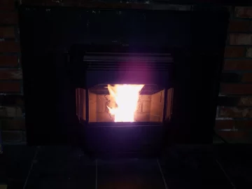

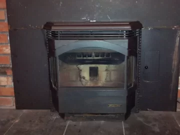

So I finally got some time the other day to get the stove out of the back of my Blazer and install it. I still have to paint but that's OK, all the parts that need paint come off without moving the stove. Here are some pictures, so yes it did happen.

Best of luck to you!
You will enjoy it, and shortly, you will start leaving your kitchen door and any windows on the porch open to allow the heat into the house.

So I have been runningt he stove for a week now and all I have to say is wow what a great little unit. I had a little learning curve with it but no problem. I am going to have to take apart the air control mechanism because it is really difficult to move and I am going to put in a CAI to help push air up to my second floor.
