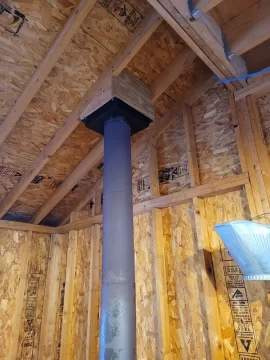

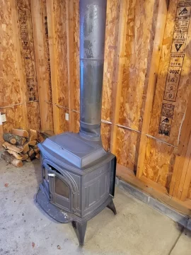

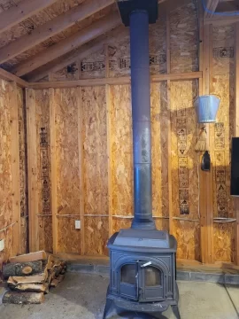

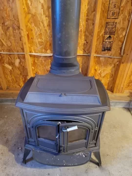

Hello Everyone!
I got this small tool shed/small barn that has existing Vermont Casting parlor stove, model is Vigilant. It works ok, doors don't shut all the way, needs door gasket, maybe alignment and who knows what else so I decided to just swap it out for pellet stove instead. This is all new to me but I'm semi handy and I think i know what I want. :)
Piping here is 8" black pipe, I'm assuming I can just take the whole thing down (whole thing is assembled from 24" pieces) and put some kind of adapter at the top (ceiling black square looking thing) to convert to 4" or 3" that pellet stove takes? Can i just use flex pipe of some sort to go from ceiling to new stove? Tractor supply sells lots of pellet stoves but was looking to get what will pretty much be easiest swap. I see all are side vented so i know i need a adapter and then a clean out T, but pretty much stuck at what do to from clean out T and up.
If someone knows a pellet unit that has 3 wire thermostat hook up so i can add WIFI thermostat to it that would be wonderful. Attached are pictures of what i have now, hopefully this will help figuring out what i need exactly as far as piping. I can connect OAK no problem straight out to outside wall, that part i understand.
Name of the parts i need would be very useful and/or links to them.
Thank you so much and i sure glad i found this forum!
Sly

Ok I now understand type "L" from stove to chimney adapter and I think I will just go with 4" pipe from stove rather than 3".
so I'm thinking i need 4 main parts here:
6" Pipe , 3" to 4" Adapter, Tee, 4" to 8" Adapter I could keep 3" all way up, what would be the safe pipe length to keep it at 3" or is it better to go 4" , it wont hurt anything?
Does this look about right for what I'm trying to do?
The only thing I don't understand is why I need flex up to the cap from 8" part on the ceiling and up? Its just for easier cleaning only? Its just this step I wont be able to do my self, at least i don't think I will be able to. It will be used very little, maybe total of 15 days per winter season, about 8 hours per day.
Thank you for all your help!
How far is it from the floor to the adapter box at the ceiling?

Are you suggesting i can just go flex from stove directly or from tee? This will make it so much easier if I can do that directly to 8" to 3" reducer up on the ceiling. Can you link what flex i need to get for this please? Im assuming its just normal SS chimney liner, it just wont be in the actual chimney. That or I'm understanding this wrong. Thank you.

9' from where stove tee would be. I don't believe I will be exceeding 15' rise to cap so 3" is what i should go with?
You can go with three inch under 15 foot. You CAN NOT use flex pipe from the back of the stove to the chimney adapter. Give me an exact measurement from the stove flue to the adapter and I can tell you what you need.
Reactions: DAKSY
slytek
Jan 26, 2021
5
USA
Its exactly 9 feet from 3" exhaust outlet on the back of the stove to the black square adapter up on the ceiling, this is where 3" will turn into 8".
