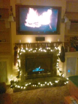

I have the Heat & Glo SL-550TRS-D DV w/IPI Zero Clearance Propane Fireplace.
It has no standing pilot which the salesman states it saves $1.00 per day when not in use of propane. I also have the battery backup to turn the fireplace on when there is a power failure. I absolutely luv those features!!
Two items they do n ot tell you in the manual that are very important.
1. The battery backup holder is for 2 D cell batteries that provide the 3v to start the electronic ignition during a power failure.
Do NOT keep batteries in the holder all summer if fireplace is not in use!!
If you do they will leak and corrode and the battery holder may have to be replaced if the acid cannot be cleaned off the contacts.
2. The LogSet must be arranged EXACTLY as in the manual and they do not say why!
The reason is that if they block the gas ports you will get gas in the room and you will smell the gas!!
That can be a real hazard! Once we arranged the logs properly, we have not had a problem since!!
Also I have found a Maverick ET-7 Remote 2 sensor Barbecue Digital Thermometer works great for measuring the Convection Air coming into and out of the fireplace!!!
Thermometer >> http://www.partshelf.com/maet7.html
So Good luck and check into the Heat & Glo for comparison, it is a real goodie and have a happy holiday!
P.S. We also got the remote on/off thermostat.
However I found that a standard Honeywell programmable wall mounted thermostat for millivolt systems works best and does not get lost under the cushions!!
