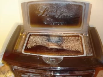

I consider myself lucky, it scorched the inside of the hopper up to the lid, but didnt get to the electrical components or bypass the asbestos strip other than smoke, if it would have gotten more air somehow, even a wierd reverse draft from the auger/auger slide ash falling into the stove, or the air wash firing up, it could have lit right up. I have pictures, just cant figure out how to link em. My insurance people see no issues with installation, venting, etc...so its wait and see. The stove did smoke long enough throughout the day for it to kill every battery in every smoke detector/CO2 in the house. Fortunately the dogs were in the basement that day.
Hmm, will try a pic...
[Hearth.com] Lopi Hopper fire
  • [Hearth.com] Lopi Hopper fire
freak thing , burnbacks, usually takes more than one thing happening at the same time. most commonly an air leak in the feed system along with an unplanned shutdown. if the stove loaded up in the chute and "went out" without completely extinguishing the smoulder could climb the chute into the auger and hopper, but for that to happen a steady (although not large) supply of moving air is needed to perpetuate the smoulder, otherwise it would die of anoxia before making it that far back through the system. my guess (not having the stove in front of me to look at) would be an unplanned shutdown , along with the air leak , negative pressure in the house can increase the potential for this as it will "suck" the air through the feed system leak i referred to earlier, this is why im a proponent of OAK installations to help cut down on the negative pressure buildup.

to our initial poster, in ragards to the hopper lid "melting" or drooping down and releasing the fire, a burnback ,even a very bad one, will not create nearly enough heat to bring this into play. when it comes to burnbacks , ive probably seen worse than any homeowner ever will (obviously created deliberately in our lab, kinda like ford or chevy crashing a new car to study what happens) nothing we ever did came remotely close to deforming a hopper or lid the fire just cannot get that hot with that limited a supply of air. what you went through was obviously not pleasant and though very rare industry wide, is not completely unheard of and its likely the worst thing you can experience with a pellet stove. its good to hear that the dealer and manufacturer are stepping up on getting your stove replaced i think you will be very happy with the XXV, its a great stove!
