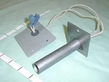

Any Leyden owners have had to replace their igniter ? If so, how tough was it ? Muss
takes a good 20 minutes... and a long handled 1/4" nutdriver.
Hello
It should not be difficult. There should be one screw holding it in from the back. See pic below (Hope this Helps)

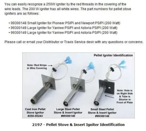

The old 250 watt Travis Ignitors were changed for large steel stoves to newer lower 200 watt ignitors the end of September 2009
Here is a good web site for Lopi Ignitors.
http://rockymountainstove.com/avalonlargepelletstoveignitor.aspx
