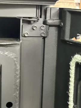

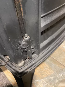

My tenants broke the door to my Harmon XXV and tried to weld it and made a mess. I can’t get help from Harmon or any service reps. I need pictures of a working door (where the eyelet skids onto the pin) so I can hopefully work to buy a new door. I can’t find it in any showrooms within 100 miles. Would someone be willing to take and share pictures?
Thanks in advance,
Craig

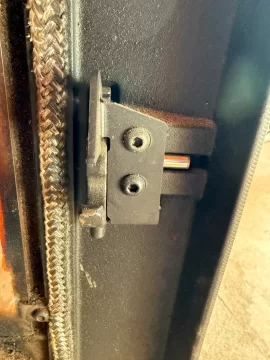

Is it the latch area you wanted?

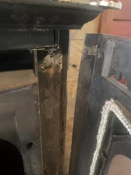

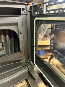

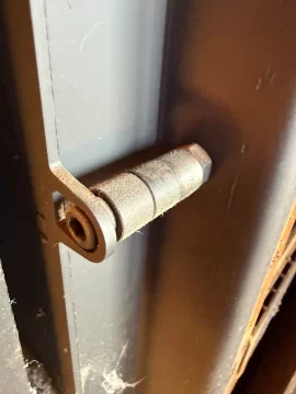

Thanks for looking. Those prices would be a lot better. I just want assurance that if I sink a bunch of money into the stove it will actually work. I did find a refurbished unit online yesterday and the salesperson graciously went to the warehouse and got me pictures. First two are how it should look and the other two is how it looks now.

Any good welder will be able to fix that, just needs to be heated up enough to be ABLE to be welded properly…I’m only a millwright but know how to weld cast metal
Thanks for your response. I'm sorry mine was so delayed. I purchased the hinge plates so hopefully a welder can add one eyelet to the door. It sure would be nice to not have to spend $700 for a new one.
