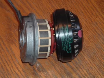

Is this what you are referring to? If so, try to work it loose w/ an awl. If it breaks, you should be able to improvise a dust cover.
[Hearth.com] m 55 enviro convection fan
yes that is the back side of the motor. Is the bearing under that cover or under the plastic cover on the other side of the motor
1. remove the dust cover, snap ring and two washers. Note their orientation. You can see the first bearing at the base of the rod.
2. separate the two halves of the motor.

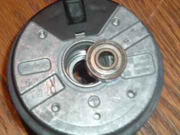

3. push out each bearing (there are 2).
4. push in new bearings; reassemble. Done!
