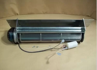

i am wondering if that stove had the old convection blower that would become unbalanced and die? your purchase date would be around the time when Enviro upgraded that motor to a more powerful and sturdier one.
also, all that noise you got on start up at the beginning of the season, could have been a loose wire or something touching the squirrel cage in the blower fan. weird stuff happens to stoves over the summer and they misbehave when you first fire them up.
i am sorry for the long post.
if you could post pictures of your motors we could tell you if you have the latest convection fan.

sounds like the squirrel cage crapped out (out of balance or bent fin). was the old motor that was replaced the old model or the new? just wondering?

the combustion motor , couldn't tell you if it was the old or new model. The convection was the new model. The noise improved greatly with motor changes. What do you mean by squirrel cage? The grate on the outside vent? That lowe's rope is a real pita. I must agree. Where did you get oem rope. I don,t mind paying more , i just don't want to give the fireplace establishment any more money.

the convection motor, which shoots the air out of the exchange tubes on top of the stove has a big fan with lots of fins that people refer to as the squirrel cage.
