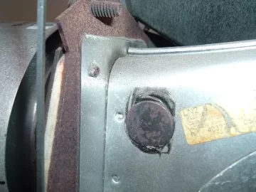

Hi again. Ran the stove, M55 steel FS last week at levels 1 and 2. Noted a faint exhaust smell after a few hrs. at level 2. Noted soot on the fan housing at the junction of the rectangular section to the rectangular foot plate (picture). Caulked that, then ran the stove during the Really Cold event. No longer detected odor in the room, but still very faint leak as noted by odor from left most convection air tubes. I found threads discussing slight leaks where I found one, as well as at the exhaust tube mounting. I did my cotton q tip test this am, and suspect I might have a leak between the housing and top of the mounting area. There should be a gasket there, but I suspect it might be leaking. I haven't ruled out the adapter or venting, but the nature of the leak makes me suspect these other areas. New install, duravent pro; adapter, 45 elbow, 3 foot horizontal out the wall to end cap. If I replace the exhaust fan gasket, do I need to disconnect the venting? Thanks for any suggestions. For the poster inquiring about buildup in the burnpot, yup, seems normal.

I ended up putting plenty of RTV on that perpendicular seam you show on your picture of the exhaust outlet.
Also check the Exhaust starter tube, the one that has one bolt on top and slips into a folder metal tab at the bottom. On mine, the tab was not bent far enough so it was not creating a tight seal which allowed some exhaust to escape from the bottom of the gasket seal. I kept the litherm gasket but also placed lots of RTV on either side of it when I reinstalled it.
I was also getting a leak from Duravent pipes and it was coming out of the seams and the stove adapter collar, in between the two metal tubes. Fill that space with more high heat RTV. And seal the joints too with RTV or metal tape.
Lastly, the exhaust motor sits on a plate that is screwed into the exhaust housing. There is no gasket between the motor plate and the exhaust housing. There is a gasket between the exhaust housing and the stove. You can buy the gasket already cut or you can buy the gasket material and cut your own.
