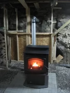

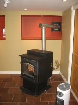

The stove is installed in my basement which I dug myself over the last 5 years on a part time basis. A picture shows the initial install in 2009 when I installed the stove initially to protect the construction zone from freezing, I had no insulation at all at this time!!!
And I loved it. So we completed the works and kept the stove, final picture shows result.

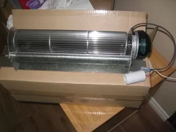

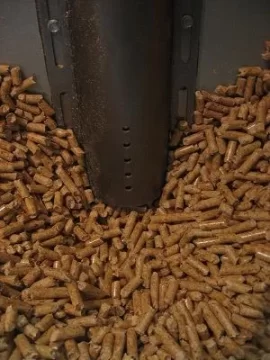

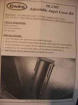

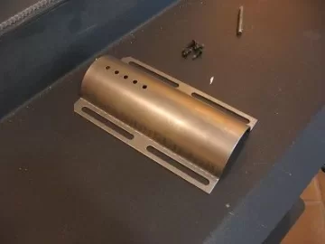

I repost some pictures about the new convection blower installed this week (under warranty) and the restrictor plate also done this week, including pictures or related docs send with the plate package.

Do you notice a difference with the new blower and or the auger cover?
Auger cover: it is installed, but it is positionned just like the original cover. So no choking yet.
New blower: it definitely pushes more air than the original, even when it was brand new. Diffcult to say by how much, but I'd guess 30%.

Yes, the convection blower failed on 31 december. I managed to revive it by prying the motor straight with the turbine axis, this prevented the end-play movements of the blower turbine and allowed it to rotate. But it was not putting out enough flow to allow the stove to work continuously on 4 nor on 5. It was continuously noisy (grinding noise)... not good!
Now, I have the new blower combined with Super Premium pellets (100% hardwood) that are really burning well. These pellets are also shorter in length.
I thought those pellets would automatically create overheating of the stove and a code #4 flashing light. But because of the added air flow, it has not happened yet. But hey, there is a major increase in heat output.

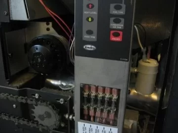

Question on one of the pictures. The control board picture on the right side, shows a white tubular canister connected to the Outside Air intake duct. And it has wire connections to something. What is that?
I don't have it on mine.
Thanks.

vinny11950 said:
Nice job, Benski, all around. I am really impressed by digging out the basement!!!!!
Thanks.
Vinny
Sounds like you were looking at the capacitor that comes with the new convection blower.
See picture attached.

flynfrfun said:
Benski,
I doubt if you will ever need to lower the auger cover now that you have the new blower. I also felt that I was getting more heat out of the stove with the new blower. I realize smaller blower equals higher temps coming out of the stove at a reduced volume. Big blower equals lower temps at high volume. I suppose there must be a sweet spot as far as how much CFM is a good tradeoff. Going by the seat of my pants, it sure feels like the stove heats better with the new blower though...
I lowered the auger cover today, now aligned with the 2nd hole in the cover plate). I think when I was set at #3 I was getting a pellet flow that should have been for a setting 4 or even 5. So I am lacking air ( I noticed today that some black soot shows on the refractory rear plate).
I think I am now back with the nominal pellet flow rate and I am very satisfied with the heat output.
