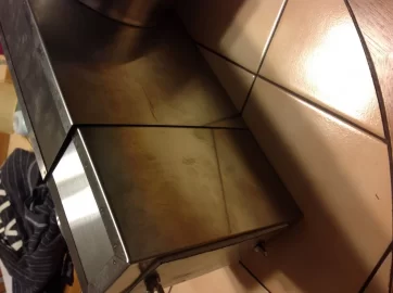

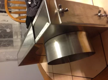

Well, I got the offset box today:-( All I can say is that the only thing that will not leak on it is the clean out door! It looks as if it will pull draft through the box and not through the stove. I can use stove cement and some screws to seal it quite well on 3 sides but not the top. I can only get the cement on the top and that is where I am concerned!
I don't have room to add cement later because once it's in, it's in! Knowing how heat can deform metal pretty good especially with flue temps. When that thing deforms, that will kill my draft and be a creosote factory. I feel confident that cement will hold this together permanently. If I can't think of a way to get a screw to hold it together. This project is on a permanent delay!
I can make my flex pipe shorter but can't make it longer. Not only that but if we don't have wood heat, the wife will kill me! I posted pix see what you think....
![[Hearth.com] Magnaflex offset box [Hearth.com] Magnaflex offset box](https://www.hearth.com/talk/data/attachments/87/87965-e0660ab3ae44c7d9ce22198c8c6a1f7b.jpg?hash=A8q_Tee3-s)
Oh and ps, they said this was variable from 15" offset minimum to 21" either I got the wrong one or they are terrible at logic/math. The box is 15" long and the offset at that length is 6". Full extended the box is 21" and the offset is 12".
![[Hearth.com] Magnaflex offset box [Hearth.com] Magnaflex offset box](https://www.hearth.com/talk/data/attachments/87/87964-e9a3ac72dbc93e1b6a48177cdb4708d1.jpg?hash=6O-uvQnrNy)
