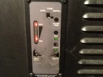

Hi coresuper....you have found a forum with intelligent and very knowledgeable people. ( I am not really one of those people...but I do have the stove you are having an issue with. ;lol )But....more info would sure be helpful. When the green light is blinking has the stove went into shutdown mode? If it is in shutdown mode,it will give you a red light on the heat level LEDs. Heat level 1-5 corresponds with error code 1-5. Each being a specific fault. How old is your stove? Did you read the thread above ? Very useful info. Especially cleaning the horseshoe area behind the fire box. Cannot stress this enough....this area needs special attention to clean. A little info on how the flame is? Is there unburned pellets in the burn pot? I have the same stove and it worked flawlessly this winter for me. A few tweaks here and there and it seems to work great for me. A search with Baby Countryside will give you a few hours of interesting reading. And the few tweaks that help make the stove burn efficiently. The picture below is my control panel in operation. Hope this helps....

Looks like board is shot.There should only one light lite up on the heat setting side.
I watched my stove during startup. Pushed the on/off button. Green led above the on /off button started blinking while the igniter was on lighting the pellets. After roughly 8-10 minutes the convection fan starts running. Then the led above the on/off would stay solid green. Does your igniter glow red during startup? Does the on/ off led ever stay on without blinking ? I doubt your control board is bad....in my opinion.
