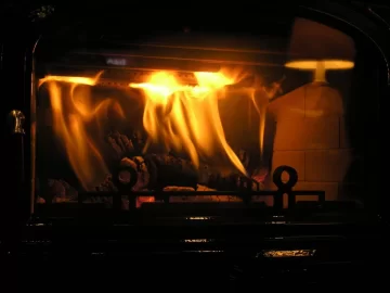

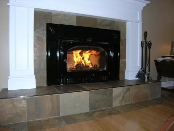

Here are some pictures, one with nice secondary combustion. For those who might worry, the mantle is made of light concrete, so is non combustible.

Oooooo the enamel finish I like it! Install looks really nice! We are really enjoying our VC.
