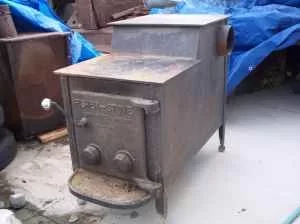

An old stove with 3 piece top and pipe cap draft controls.
I would have traded you the Baby Bear in my avatar for it and saved you all the trouble.

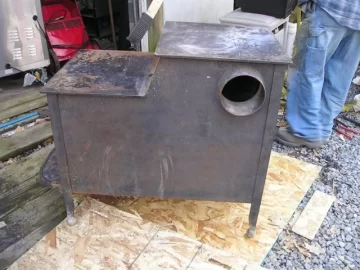

A flue damper is a chimney control, which affects the stove. It is not installed for the design of a stove model. It doesn't matter where a damper is installed, it is the same as a water valve in line which restricts flow. A flue damper slows velocity of flow. Normally installed where ever it is comfortable to reach.
If you are adding secondary burn tubes, you would not use a damper. You will need he lowest pressure obtainable that your chimney creates without slowing the flue gas velocity, which is what a flue damper does.
The outlet pipe needs to be inserted so it extends down below the top by 3 inches. Baby Bears did not have top outlets due to decreasing the already small cook top.
The baffle size and angle depends on chimney, connector pipe configuration and if this will use secondary burn tubes under it. I don't recommend adding tubes, but I don't recommend destroying a collector piece Mama Bear either.
Here's your pipe caps Todd.
I would say a 3 piece top Mama Bear was a bit more coveted than a common set of Bear Feet you can find for $150. I'm not sure about washing with acid. I hope you neutralized them after that washing. Use metal polish for precious metals ONLY. (such as for brass, silver, bronze, and gold)

On my end, my application essentially puts this in non-breathable structure so my plan is a to add air just behind through a pipe that runs outside the structure with the

Good info. My thinking was that the higher it's installed in the chimney, the more radiative area you get as you're trapping the hot gases below the damper.
Perfect. My plan was to never use the front air inlets but instead to install a pipe with holes just inside the door and run to outside air which would be regulated by a ball valve. In my situation, pulling air from inside isn't a good idea as the structure is literally nearly air-tight.
Good info. I'll guess I'll figure out the baffle myself. What exactly about these stoves is collector-worthy? Yes there is some value in the door assembly but the rest is literally less than $100.00 in full-retail priced steel and about 20 minutes on a plasma table or lets say 1.5 hrs with a hand-held slicer and maybe 6 or so 75 cent grinding wheels. 1 hrs worth of welding? There is nothing to these these stoves other than the cast door and curved spark or spill pan or whatever you want to call it.

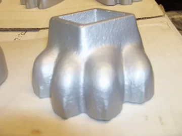

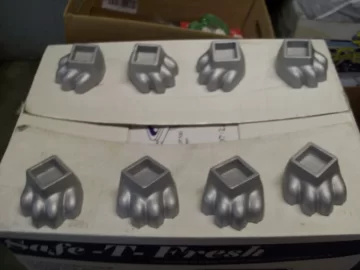

Making reproduction feet is not difficult. Over the years a few have tried to reproduce and sell fakes. Here is an extremely poor try with cast iron;
[Hearth.com] Mama Bear into Baby bear. [Hearth.com] Mama Bear into Baby bear.

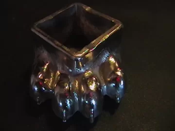

Pressing your feet into "green sand" for casting fine detail results in quality castings. This is solid brass;
[Hearth.com] Mama Bear into Baby bear. Much nicer than the originals, but worthless to a collector.
Your stove should have had adjustable ball feet. Those white brass plated angled feet were an accessory sold much later that came with washers to set inside for leveling. They are not just for looks, they are levelers.
Cleaning with anything acidic can get under the plating setting up corrosion which bubbles the finish in time. The base material is Zamak.

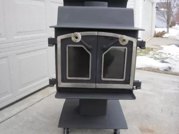

Sounds like your tight structure needed a Convertible Honey Bear (removable pedestal) with an outside air intake that was also certified for mobile home use. Since your state isn't known, I can't tell you if it would be legal where you are. I know what you have is not legal to use and depending on state, not even legal to possess. It would have been the correct BTU capacity, with add on blower option still available. They have glass doors if you wanted to add secondary burn tubes and easy to do without damage or modification to the stove. Those feet could buy you one of these. You could have sold the stove for 3 X more. Us east coasters pay up to 300 for that stove and 300 to 400 to ship.
[Hearth.com] Mama Bear into Baby bear. Double door Honey [Hearth.com] Mama Bear into Baby bear.
[Hearth.com] Mama Bear into Baby bear. A bit more rare, single door Honey.

You're fine with the pipe centered on the upper top. With a baffle, it changes the hotter upper cook top to the front lower top. The front was simmer, and the back was cook. Baffle plate revereses it. The baffle thread explains it in detail.

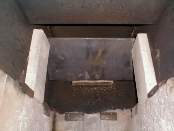

This style of baffle plate works very well in my Mama Bear. I'm pretty sure coaly posted this pic on the forum.
