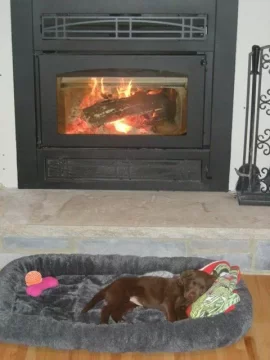

I squared off the rock - fixed the drywall, and installed a stone ceramic tile (since we couldn't match the rock) and it was just that easy. Looks great, heats great. On my third year of total wood heating with it. Here's my pup with it before I installed the tile.
I looked forever for replacement rock and what I found was - the builder made my fireplace out of left overs and they had faded too. Squaring it off and using a tile surround was easier then doing a complete re-over on the rock.
I wanted to do a free standing stove with an alcove set up (extend the hearth), but my wife wanted to keep the same look and she won out. I was not convinced that this unit was a performer. I thought I was just trading one fireplace for another. Boy was I wrong and my wife/Woodstove store right. Really - it's a good sized woodstove sandwiched between (bottom air space which has the blower and sucks air in) and the top airspace where the heat comes out. The sides give the necessary clearances. You can install this unit flush to wood (hence zero clearance). As my pup can attest - it puts out great heat.
