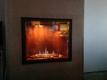

Thanks everyone! Resetting it with the wall switches worked. I wonder if we had a power flicker and it lost its settings waiting for the gen set to kick in. The batteries were not properly connected, so that backup was offline. Anyhow, its working and I am happy to have it back. Here's a pic. We are still making tile choices, so it's still unfinished. We chose the copper backdrop, and even with all the work to get one that was blemish free, totally worth it. Again, thanks. Your advice was just what I needed.
