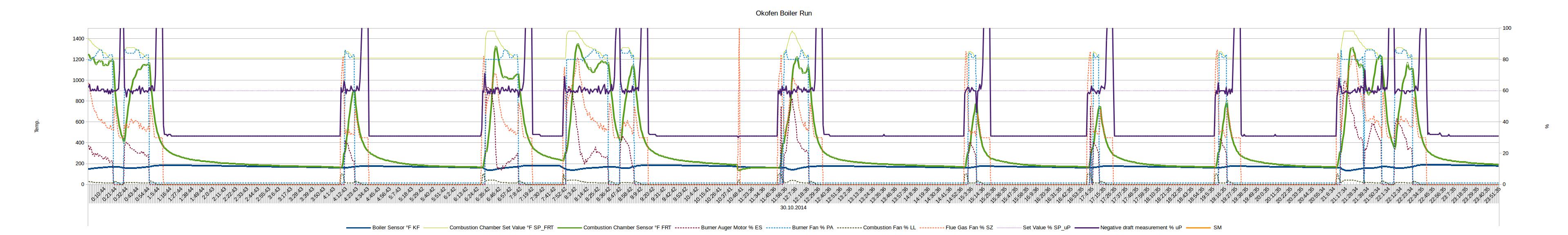

Yes that is what we have. Have set the following values..
P202 170
P163 160
P281 140
I have been playing with the settings since April. For the summer this worked quite well, I set the Summer/Winter switch to Summmer and it would fire once or twice a day for DHW. Run times where longer with the lower settings but with our tank we never had a DHW shortage (two adults).
Turned on the system to Winter two weeks ago, thinking that extra heat would be good turned up the run temp to 170. No good. Noticed extra cycling in the boiler and set the run temp back down to 160. Waiting on a weeks worth of data to filter through... hopefully it helps. As for if Im saving pellets its hard to say. I have 3 ton hopper and its hard to gauge usage. I do know that boilers are most efficient when they run over time, and since these settings accomplish that I would like to think its helping.

Velvetfoot, in my case "extra cycling" is when there is call for heat/DHW the boiler fires to meet demand hits the high temp and goes to shutdown but there is still a call.. after 5-10 min re-fires to meet demand again, and then shuts down. It happens if I have the high temp shut off to close to the operating temp best I can tell. Its easy to see in the data you get a two spikes of output next to each other. I'm sure there must be a better name for it.
A current graph of 30OCT2014 Note the long runs at night when its colder... durring the day I get lots of stops starts.. depends how sunny it is. Im curious to see how this works out when is actually cold out...
