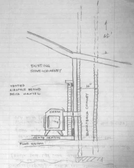

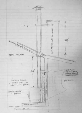

Chimney will go straight up about 5 ft from stove at low side of a cathedral ceiling (common-framed) and standing-seam metal roof, then up about 8 ft, so it will be two ft taller than our old masonry chimney (which stands about 2 ft downhill from where we'll install the new one.) I figure we'll be able to brace off the old chimney. We can cap off the old one and maybe use it as a platform from which to clean the new one.
Welcome! Metal Fab is fine for the job. My bigger concern is the short chimney in a mild climate. Not sure if the Oslo is the best choice here. How large a space will it be heating?

I didn't think of the relationship between stove size, chimney height, and climate (mild by comparison). So let me add more info.
We burn fires when temps are mid-40s and below. (Gets down to teens some nights.)
Our hearth is in a room about 320 SF with ceiling at 6:12 pitch, at 8' to 13' high... but there are two adjoining rooms with no doors, one being an upstairs room. Total SF of all three spaces, plus a bit for the top of the LR, I figure to be about 1000 SF. The whole house is 1800SF.
Here are some sketches I just did this morning to give a better idea of our set up.... both the existing stove set up and our plan.
