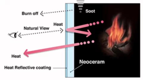

Some stove glass, like Neoceram, has an option for a heat-reflective coating. This is to reflect infrared heat back into the firebox. If that is the case with this Stuv, the bond may have broken down.

Neoceram/pyroceram 'glass' has essentially zero thermal expansion - that is why they use it for stove glass. So expansion/contraction issues are non existent. Plus, the IR coating is typically an atomically thin metalized layer... you can see through it,, after all... so not like bending a plate of steel.
You mention flaking off and cleaning the glass - is this on the inside of the stove? As shown in the pic, the metal layer should be on the outside. Though again, it's a few atoms thick, so not like there is much to 'flake off'.

It would help to have a picture of the issue. The neoceram image shows the coating on the outside. Other coatings are available on this glass. One is half-mirror. I don't know what Stuv uses and we have not seen the problem, so I am just guessing this may be the issue. The best place to start is with the dealer or Stuv tech support.
