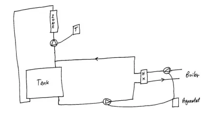

Nofo - does it need to be more complicated that this? Boiler aquastat turns on/off circs to charge tank depending on boiler temp. Zone circ has its own thermostat and draws from a T at the top of the tank. If boiler circs are on, then zone circ is taking hottest water directly off supply line, and if boiler circs are off, then zone circ takes from top of tank. Zone circ returns to bottom of tank. May also need zone valve on zone to prevent thermo-siphoning.
Looks like zones would be on the unpressurized side of the world. Is that OK? It also means that you'd be feeding your zones through the HX all the time, rather than directly. If the zones are baseboards that need the higher temp, you might be losing a bit of capacity that way.
That having been said, it should work. I think the integral check valve in the circ would prevent thermosiphoning.

I'm not sure we're looking at this the same way, or maybe my view is in error. My tank is pressurized LP. I'm showing tank supply to zone T'ing with hx supply to tank. Water will take the path of least resistance, and my thought is that the draw will be all or mostly from the top of the tank and return to the bottom of the tank bypassing the hx. If instead part of the draw is from the hx, which also means pulling cooler water off the bottom of the tank, that easily could be solved by a NC zone value on the hx supply line to tank, which opens only when the hx circ supply is on.
Sorry - I didn't read it carefully enough. I though it was a proposed solution for the non-pressurized milk tank.
If the tank is pressurized, then why the HX between the boiler and the tank? You could remove that, and then I think you'd have the simplest possible solution. Even with the HX, it's simple enough.
You're absolutely correct. Right now the hx is there because I started with an open system, and it was easier to plumb in the pressurized tank in place of the open tank rather than change the plumbing to pull out the hx.
Also, with the open system, and some concern from freeze-up during an extended absence in winter, I was willing to allow a freeze problem in storage but not the Tarm, so I have anti-freeze in the Tarm, and the hx isolates the systems. This all may change in the future, as I will need freeze protection on the pressurized tank investment (the open system cost me only $125 plus some plumbing -- it was my first experiment with storage, and I didn't want to invest a lot until I was convinced of its value).
