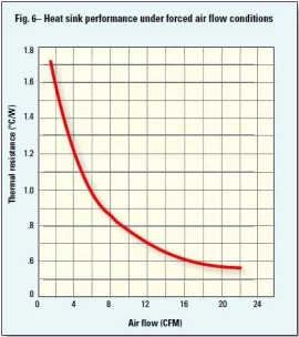

Higher air flow will extract more heat. Even if your hand "feels" that the air is less hot, it contains more total heat. However, the law of diminishing returns applies as you add more flow (See chart).
I work with heat generating equipment that uses thermostatically controled variable fans. When the internal components are heating up, the fan speed goes up automatically to avoid overheating. That's all the proof I need!
I'm no engineer by any means, but I feel like there is a big difference in cooling a piece of machinery for the sake of keeping in cool, and trying to extract heat for the sake of heating a space.

The original poster asked for maximum heating efficiency, not maximum comfort. Everyone can do as they wish. I do not run the fan at full myself as I don't like the increase in noise.
Cooling a machine and extracting heat from a stove is not the same.
If you run the fan on high so it cools the stove then you are not running it efficiently at all. Just means you will be turning the feed up more than you might need to vs lower fan speeds extracting less heat at lower stove temps.
Why not? You are trying to extract heat from a heatsink in both case.
You are not "cooling the stove more", you are keeping more heat in the house instead of throwing it out the flue. The ratio of heat produced VS the heat extracted is how they compute the stove efficiency. The actual fire don't care for where the heat goes.
If the flue is becoming too cool, then it's a bad stove design.
