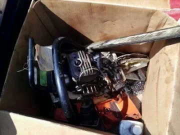

I will do this to my 650 once I get it back together and running.
Its in no shape for a muffler mode now. Well I could do one, but not much point till I get the plastic in.

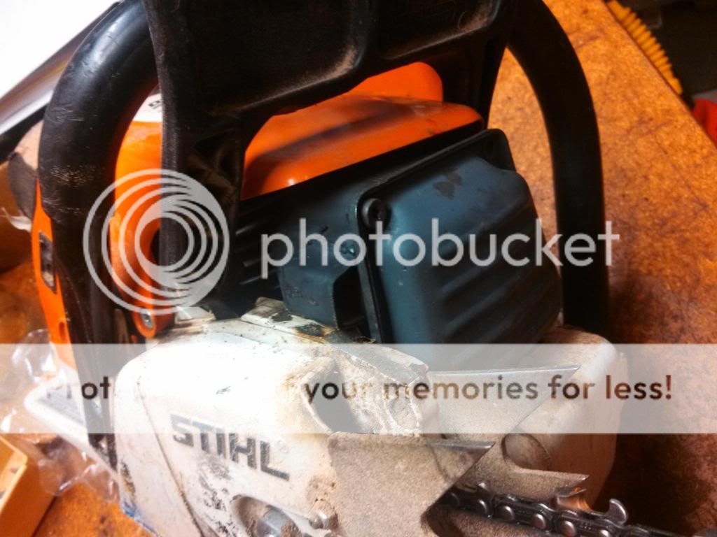

I ended up removing the entire baffle from the muffler. I used a dremel with a carbide bit to enlarge the stock hole until it was pretty much the entire area behind the stock deflector. Then I bet a piece of sheet metal and welded it on as a deflector extender. Finally I spray painted it with high temp grill paint and retuned with my fancy new tach. Cut some hickory today and it works well... throttle response seems better.
[Hearth.com] MS660 Magnum Muffler Mod
Be easy on the welding... this is the 2nd thing ever I've welded and didn't feel like grinding much.
