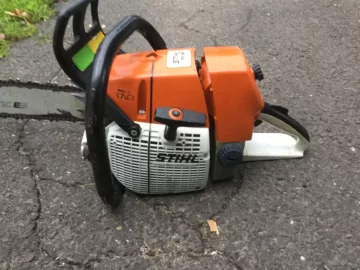

So I've added another saw to the collection and I've got a couple questions hopefully some of you can help me with. First, I can't find a parts manual anywhere - Is this a dealer only type thing? Husqvarna I can go right online and look up what I need, so when I call I just have to give them the part numbers. Secondly, is there any way to tell how old the saw is? I've noticed 2 different style pull start covers on these saws. One has a Stihl plate while the other has the word Stihl built into the cover.

Nice saw. That's quite the line up you have now. Didn't you start with a Husq 455? I'm not 100% sure about either question, sorry just wanted to comment on the saw. I ran a 661 recently but unfortunately it was overshadowed by the ported 395XP that the guy also brought with him.
Stihl is unusual in that they don't freely distribute parts and service manuals publicly. People do post them on various websites, but Stihl's legal eagles eventually get them taken down. They don't work too hard at it, though. I usually Google something like "Stihl [model] parts pdf."
Here's a currently-active link
for the 660.
Also: unlike Huskies, the date of manufacture is not baked into the serial number. There's often a month and year indicated on a large sticker on top of the base of the rear handle, but it seems to have been removed on yours. The top covers and starter on yours are a relatively recent style.

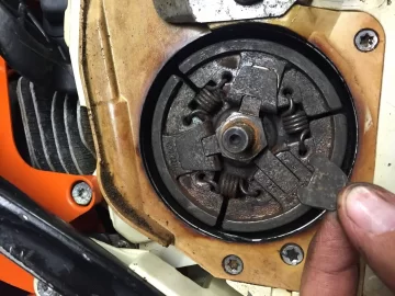

[Hearth.com] MS660 Questions Dug into it a bit when I got home today. Found a retaining clip broken and loose inside the drum. Should I buy new clips and rebuild it, or buy the entire clutch? Also you can see the burnt sides where the drum is making contact with the plastic. The center bearing fits pretty loosely inside the drum which is allowing too much play. Replace drum and bearing? I'm a diesel mechanic by trade, so I sort of have an idea what I'm doing.
someone who knows saws better than me should chime in but the color kinda concerns me on my 66 or the 46 the clutch doesn't have that dark burnt on oil look. might be your oil pump in behind the clutch is leaking. or and im going out on a limb on this one bad crank seal.
Time for a whole new clutch, including drum and bearing. You definitely don't want one of those shoes letting go while it's running, because it's likely to be driven around in there, breaking the oil pump and banging up parts of the crankcase.

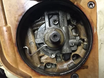

Ok so I'll order clutch, drum, bearing, u clip. Is there anything I should be changing while I'm this far in? [Hearth.com] MS660 Questions
Lift out that worm gear with the square wire arm that drives the oiler, and check that the wire arm has a good grip on the plastic gear. Sometimes they loosen up, and then the oiler doesn't push enough oil to the bar.
