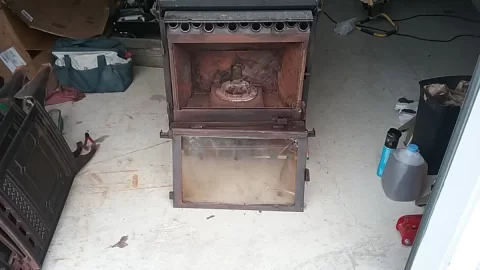

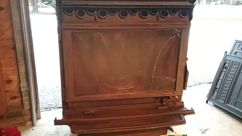

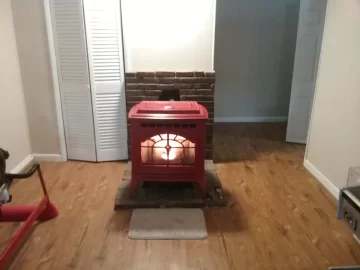

I bought this about a year ago and still tinkering on it. It was in really bad shape and thought I might of screwed up buying it. Right before christmas and wife wasn't happy but after a month working on it and getting it up and running shes happy. Pictures kinda say it all. My question is why is the exhaust side outside of stove really hot? I have but gasket material in between baffles keeping the heat in stove instead of losing through exhaust

Your going to get some heat loss. It’s an inherent characteristic of all pellet stoves, none of them are 100% efficient. What baffles did you insulate? The side pnls are actually meat to radiate heat also. The exhaust side will be higher because of the path heat takes to exit the stove. Looks like a winner and running good. Congrats on getting out of the dog house,

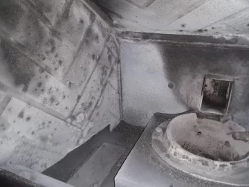

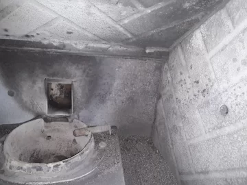

Yes getting off the bad list was good. As it was a rust bucket when I got it I made the back baffle out of 3/8 steel. So I'm guessing all the baffles aren't as tight as they should be so I just put gasket material into each corner and top. I'll show you with pictures. I also had to block off clean out to get a great burn.

Ok so some terminology is confusing me a bit. what are you calling a baffle? did you replace the entire back wall of the fire box? have you checked and cleaned the combustion & convection motors? weak motors will not move a lot of air.
Yes the back baffle I made. 4 baffles 2 sides 1 top and the back. Yes i rebuilt both motors and clean entire unit monthly and weekly cleaning of fire pot. It works great was just wondering if the exhaust side gets hot normally
are they removable? I'm sorry Shu2 i'm trying to wrap my head around what i think you have done. I'm guessing you rebuilt the entire firebox (all new walls welded in)? or the removable panels to facilitate cleaning?
No worries. So this is 2004 stove. Yes all baffles are removable. I made the rear baffle. The rear baffle was broke in half when I got it. This spring I'm going to dismantle as much as I can and rebuild from ground up. It's a great stove and we love the quadra fire. Have a Castile insert upstairs
Ok got it. That vintage of stoves were actually designed to radiate heat along with the convection blower. So with the insulation between the actual fire box and your modded baffles it will be sending a bit more of your btu’s out the chimney instead of into the room. I really don’t know much more about that model.
