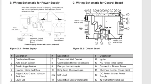

Have you checked all the fuses? It appears there are 3 fuses. It sounds like the combustion fan failed or the control card failed.
I have to tell you this does not look like an easy stove to troubleshoot based on the schematic.

Check the overheat snap disk also. It can be reset although it does not sound like the stove got hot when it failed.

Take a look at the schematic in the manual page 35. It shows a fuse on the power supply board, and 2 on the control card.
I posted a link to a manual but take a look at your own paper manual as well.
I don't see your attachment. In my book page 35 is component location. There is no wiring diagrams or even a fuse location in my book.. I found out about fuse a few years ago on this site.
Oh? It was posted at 9:19 and it's a link.
