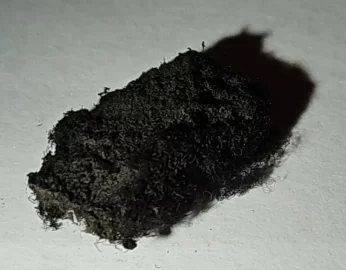

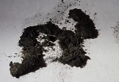

Hello,
I have a strange issue that i believe started maybe last year but maybe earlier. I have a the Mt Vernon AE and it is fairly old (close to 18 years or so, I think). I recently cleaned it and got it ready for this year use. The stove started up and ran fine. A while later I walked into the room and noticed a black "spot" on the rug a few feet out from the stove. See attached pics. It is very light, very black ashy, and fails apart at the touch leaving your fingers sooty. It reminds me of the texture of dryer lint.
I have had this happen a couple times already this year and noticed it a few times last year. I believe that the only place it could be coming from is out the top inside air vent ... the vents that provide the heat to the room. I am just confused as to what it could be and concerned if there is some safety issue. I do clean the blower "squirrel cage" but it gets dirty again pretty quick. The stuff on the cage is similar in texture. I don't clean anything after the blower as I don't really have much access to it and it was never suggested that it was needed. Could it get hot enough to char something?
Anybody seen this before? Any thoughts are appreciated.
Jim

That could indicate a leak and do a full internal inspection. It might be time to replace it.

Whitenuckler, I agree it needs a full inspection. The thing that might bother me is that there is no complaint of smoke heavey during start up but also a faint smell when running. Also, the amount of ash seems more than a little through a small hole. It is also black, suggesting incomplete combustion. My feeling is the heat exchanger tubes may have a light coating of dust, lint, and hair clinging to the exchanger tubes. Especially because of the stove's age. Jlar also says the cage gets dirty very quickly. I think I would first try high-pressure air (compressor) blown into the exchanger tubes and see just how much crap blows out. Just a thought
Are you missing a cat?
Tom
Not familiar with the Mt Vernon AE but I would guess that something is not getting cleaned that should be.
That seems like a lot of ash, there's got to be a trail or clues, that should be obvious.
I would shut it down and tear it apart. There's got to be a gasket worn, crack someplace or something not put back correctly.
Is your stove an insert? Chimney clear and clean? Vent pipe clean? Door gasket?
I would not hesitate to call the factory or the local dealer, it would be worth the service call.
When all is said and done, it will end up being an easy solution; but you have to hunt it down first.
Good Luck
Tom

If you have, or can borrow an inspection camera and look at the heat exchange tubes that would be a good start. Because the stove interior draws a vacuum, the ash should not be coming out. The room fan blows through the exchange tubes, so if there were a bad weld or crack in them that could explain it. In your picture, is that an ash deposit on the floor in front of the stove?
I do have a cheap inspection camera that works pretty well. I will run it down through the vent at the top tomorrow. I assume that would be my best access to them? I can remove the convection motor and run that direction but the access is tougher as the stove is in a corner. Very cramped access.
As for the picture of the ash. Yes, I picked it up a couple feet in front of the stove on the rug. Again, it is like char cloth or black dryer lint and it was 1/2" in size or so ... size of a nickel maybe. It doesn't resemble anything that I have ever cleaned out of the inside of the stove, either in the firepot or in the baffles behind the mill. It is "hairy" ... like blackened dryer lint (you can see it in the zoomed pic). I will snap a pic of the squirrel cage too.

If you can identify what it is, then that would help. Only ash could possibly be coming out. The stove will suck room air and blow it threw the heat exchangers. Is it possible the room blower is picking up ash dust or blowing paint residue out the front?
Or if it is lint-type material and the heat exchanger reaches 320::F. Then that material will flash over, giving the appearance of ash .
This ash will then be discharged from the heat outlet of the stove
You say you cleaned your stove but did you clean the chimney pipes and check the fresh air intake if you have one. To me that looks like something is blocked and the startup cannot push things out fast enough
