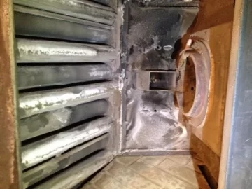

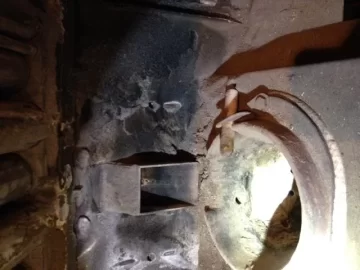

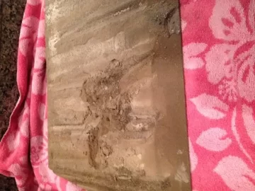

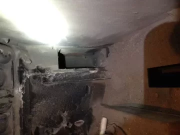

First pic is the backside of the upper baffle cast. A few inches of ash! The other 3 pics are pretty self explanatory. Again, I was shocked at the amount of buildup hidden behind the panels [Hearth.com] Mt.Vernon Quadrafire issues…..AGAIN! [Hearth.com] Mt.Vernon Quadrafire issues…..AGAIN![Hearth.com] Mt.Vernon Quadrafire issues…..AGAIN![Hearth.com] Mt.Vernon Quadrafire issues…..AGAIN!I used a wire brush to clean the cast panels outside and brushed them off clean. I should have taken an after pic before I re-started the fire, but it looks totally different now. **UPDATE** it ran all night without any issues. The flame stayed constant and there is nearly no ash buildup anywhere. So far so good
Did you clean the heat exchanger tubes also? kap

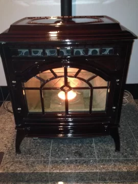

Yup, I cleaned the heat exchanger tubes also. I will take it all back apart tuesday night when I get my new ash vac so I can clean it even better tho. Here is a pic from this morning. All good. Thanks again everyone

Yep, your stove was plugged up from lack of proper cleaning. Put some anti seeze on the threads of the screws that hold the rear and right side panel on. My experience says the screws only need to be tight not cranked down on or they can be very hard to get out next time.

Thanks for the pics:) That would explain your shut-downs! Keep it clean and it will be able to do it's job with minimum problems!
