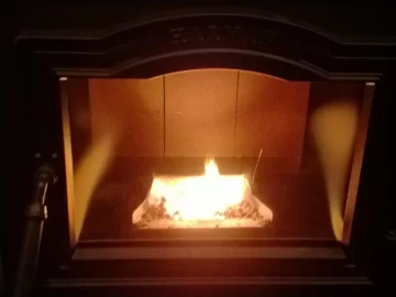

Ya got it running for a test hop and first burn off, the topper will go on the vent pipe today. Ended up venting out the chimney, 27 ft vertical with a clean out T at the bottom ( 4" pipe). OAK another day. I fired it off in stove temp auto, feed at 4 and low medium fan, temp at 3.5,- 4, then cut the feed to 3. Set the fire alarms off in the house from initial residue smoke off the heat exchanger tubes and baking paint, that took maybe 20 min to clear with an open window and house fan and all was well ( it was expected, this isn't the first stove we have run and the fan was on standby just for this purpose !). Just have finishing touches and inspection to do. Some day we might pretty up the old fireplace front. For now you guys have to live with this photo, can't say we didn't do it !!

Yes seems so, its too warm to crank it up enough to find out today. That's fine cause it passes the low heat output test I was curious about for the up coming shoulder season ( it's 42 outside today and was 32 overnight).

Incidentally, getting a pattern of smoke stain on left and right side of inside of glass. Is that normal for 24 hours burn time [Hearth.com] My avitar shows first firing at ignition new P61a ? It has done quite a bit of maintenance mode today ( room temp manual).
Looks just like mine.
