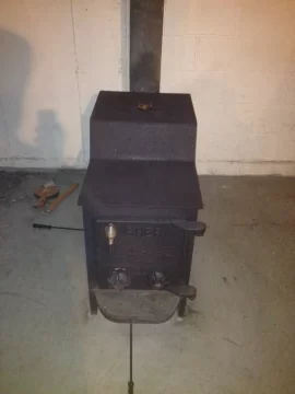

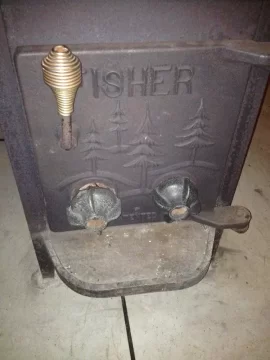

here is my fisher. Pretty sure it's a Momma Bear. measuring in at 30" back to front edge of plate.

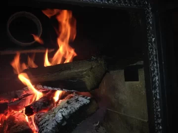

Very curious as to how old it is. I also found it's missing the second row of bricks inside, but no clips to hold a second row of bricks either. Is the gasket supposed to be on the door, or the door jam? I took the old one out to replace from the jam, but found a large amount of epoxy in the door groove as well.
[Hearth.com] My fisher stove[Hearth.com] My fisher stove [Hearth.com] My fisher stove [Hearth.com] My fisher stove
Welcome to the forum, Yes it's a Mama Bear.
No gasket material is required. Sometimes you can scrape or chisel the old cement off if it is deteriorated enough. Otherwise, wire wheel all gasket cement or glue off both door and stove. It must be clean metal to metal contact. The door seal is the iron channel iron welded to stove front that makes contact in 3 places all the way around. It is air tight as designed. The raised portion on back of door makes contact in the center of door channel and the channel edges make contact on the back of door on both sides of the raised portion. All those contact points must be clean.
Not all stoves have the second row of bricks. Many don't and they work fine without.
You have the first stainless steel door handle spring and early 4 fin draft caps; probably '76 or '77.
Keep the door hinge pins and draft cap bolt threads coated with high temp grease or silver anti-seize and it will outlast you.

Great! I have a couple cracked bricks inside...I might try replacing them all. We have a couple wood stove places local I'm going to see if they have the right size bricks. These might be all the original bricks.
Cracked is not a problem until they are missing chunks. Not a fun job, but not difficult.
They are a standard fire brick. Most masonry supply stores have them. $1.50 around here. Ace Hardware sells them by the case that comes to $3.00 each.

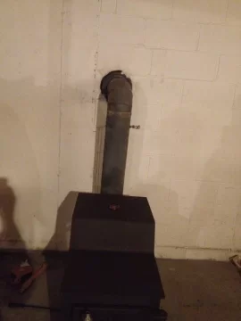

the jotul is connected to a full stainless liner. 6" inside the masonary chimney.
The fisher is connected to i believe, 6" square stove brick up the chimney from the basement of a 1 story home.
