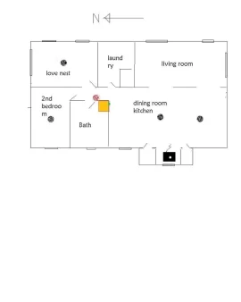

my floor plan and heat distribution
devinsdad
Sep 25, 2009
227
northern NY
Here is my home layout. The black circles are the ceiling fans and the orange square is where the furnace is located.The red circle is where I placed a small 9 " fan on the floor blowing towards the kitchen and I use the ceiling fan in front of the stove only. The green dot is where the thermostat is located.I can notice no difference with the ceiling fan rotations.Which works best for you? Is there something else I should do? Just use the ceilings fans in all rooms? The stove is steel and I was told I didn't need a blower. Actually was told to just take $300 and substitute for newspaper. ceilings are all low . Thanks for the oopinions and advice
  • [Hearth.com] my floor plan and heat distribution
Reversing the ceiling fan is more for comfort. I don't think it will change heat distribution greatly. No need to use ceiling fans except for in the area where the stove is located. Do you have a bigger table fan or box fan? If so, it will move more air at low speed. I'm using a 12" table fan for my office, but have an easier area to heat. Ranches are a challenge. Place it as close to the 2nd bedroom door opening as possible.
Have you tried pulling the cool air at ground level out of the bedrooms? Point the fans up the hallway. The vacuum behind should pull in warm air.
I reverse our ceiling fans on low to stir the air, which also avoids the stale air of a closed house.
