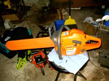

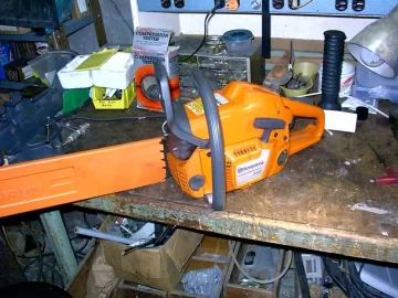

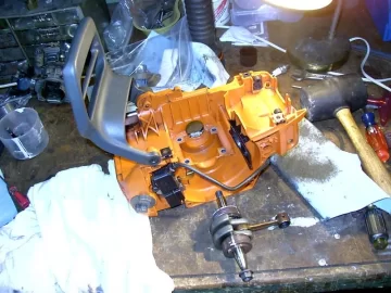

I found a non running Husky 350 on CL for $50, the saw looked to be in good shape other than it had almost no compression.. I figures I would give it a shot and see if I could get it running again. I ordered a aftermarket piston and ring kit from E bay,
cleaned up the cylinder, replaced the fuel line and filter, fixed the air leaks, and replaced the carb diaphragms. I gave everything a good cleaning and put it all back together.
So far I have only run it for about half an hour, but it did seem to run and cut quite well.
