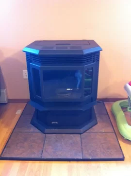

Well I finally got my Classic bay 1200 installed this weekend. Now to wait for my pellets to show up next week to fire it off. I am excited to see how it works. I am pretty sure that I will have to fabricate a little extension on the end of the outlet to block it better from our prevaling south wind. [Hearth.com] My new Installed Quadrafire Classic Bay 1200!
Reactions: smoke show

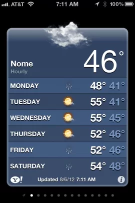

Nice stove and install. What's the temp in Nome these days?:cool:
nice job, enjoy the warmth, What kind of pellets are you getting?

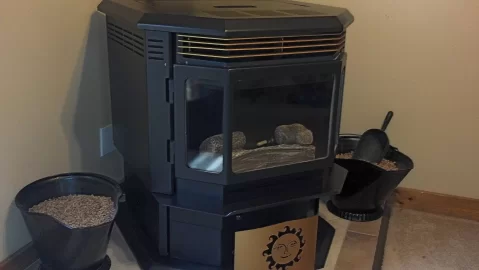

It is nice and balmy here in Nome this summer. I bought some brand out of Seattle should be here this week I hope, so I can try the stove out pending the gate gets here to keep the kids away.

Looks great... As for the wind block, I used some Pavers stacked up like bricks on both sides.
If you use a stat, a 2° swing is best (sometimes 3°). If set at 72°, For example, it will kick on at 70° and kick off at 74°… This will help to keep the stove from short cycling. A short cycle on the Quad keeps the firebox warm and the thermocouple may sense higher temps, causing overfeeding and an overfire.
Looks great though. They are heating monsters.. I just painted my Grill Gold. Took about 20 minutes and $7 for the paint. Thinking about doing the Door?!?
