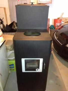

My New Years resolution is to make it easier to keep my house warm. I found the way to make my resolution come true on Craigslist.
I think I have my work cut out for me....

That unit looks VERY FAMILIAR?? Congrats...
How big is your house? Are you using existing HVAC or using as a Freestander? If using existing, how many registers and is the ducting insulated?
That hopper extension may be something I buy. It's shy of 3 bags in stock form, which is plenty, but an extended hopper is on my list.

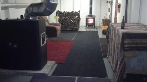

[Hearth.com] My New Years resolution comes true, thanks to Craigslist
Reactions: 343amc
Oh and 3 guys with an appliance dolly. Using 2 extra straps (watch exhaust and Intake port) with two guys up top, we used 2 6' (4" nylon straps) straps and choked them onto the handles. Allowed the 2 guys to almost stay at the top of the steps, and one guy under it, to guide it down. Worked like a charm.
Nice looking room. That makes the side of the basement that my unit will be installed in look shameful. I can't quite make out what is in the bottle though. :rolleyes:
Great lakes Brewing Co. Christmas Ale! Mmmmmmmm
That is one side of my basement. Its kinda split in half, with a Pool room/Bar on the other end (opposite of woodstove).
My Goal has been to finish and insulate that side, but having more BTU's than i can shake a stick t? I dont really need to :)

I was downstairs figuring out where its going to sit and what venting pieces I'm going to need to pick up. I'm going to use your idea and put the unit up on blocks. My basement flooded about 7 years back and I had 4" of water down there. That's what happens when there is 2 feet of snow on the ground, it hits 60 degrees and starts raining. Pump couldn't keep up and the rest is history. It hasn't happened since, and I hope it doesn't happen again.
