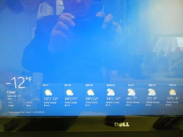

Lets see, 15 seconds to scrape the pot or shut down and clean everything about 15 minutes not counting cool down time. Only been getting a day or two of normal outside temps every two weeks since Novemberrrr.
Looks like you will be in shorts and a t-shirt on Sunday!!
