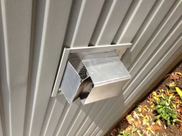

Can you post a pic of the outside of your house showing the vent cap & the siding?

Here are your pix, Bennett.

Here's what I will say about the siding melting. Your contractor forgot to install a vinyl siding shield, That item moves the cap about 3-4 inches out from the wall & mitigates the chance of the heat exhaust affecting the vinyl. Have him return & remove the cap, install the vinyl siding shield & replace the damaged siding...
Thanks for your help Daksy. E fireplace store said that is the complete kit. There were no other parts in the box. Did they short me this part ? The installer was here again today and said there was nothing else to install. Where can I buy this extender? He thinks it's a bad regulator. He adjusted the cap to vent the heat more horizontal than vertical to see if that works

It's a Duravent siding standoff. They said it's the correct product but the deflector must have bent in shipping. They told me to bend it so the exhaust vents horizontally. I did that. We will see what happens. They said it already has the extension installed.
i've never seen a duravent cap that looked like that...
anyways, it appears the siding kit is installed backwards....
check the instructions for yourself.
(broken link removed to http://www.duravent.com/docs/product/L954_W.pdf)
Update...So it turned out to be a bent diverter on top of the siding standoff kit. The diverter was almost straight up ( it must have bent when it was packed/shipped) so all of the heat/exhaust was going straight up (melting the siding). My installer bent it back to a 45 (per the manufacturer's instructions) and now the heat vents away from the house. Thanks for everyone's help here. As a side note, I called 4 local fireplace retailers for help and not one wanted to get involved because I didn't buy it from them. I told them I was happy to pay them for a service call but nobody wanted to stop by. Sign of the times I guess.
