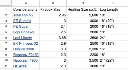

Napolean was in the house when I moved in has ran well the last two years. Found some cracks and other issues with the secondary cross member and decided to start looking for a replacement. I have been shopping for a heat pump replacement but may now replace the stove first. Issues with the napolean is it takes up to a 22" log and all my wood is 16-18" in length. so never felt I used all 3.0 cf of the fire box but have been able to keep the house warm with it as primary heat in the winter. Heat pump works down to -5C then I turn it off as it turns on the electric backup strips.
16" equivalent would be 2.1 cf firebox and 18 would be 2.5 cf when compared to what I actually used. Stove must be north/south, I don't want to have to think about adding wood to the fire. I have made a small list I have been looking at. Are there others that I should consider? Ottawa, Canada20' chimney with T, 90 and 3 foot horizontal so by the book not the best for catalytic but Princess is a possibility.
