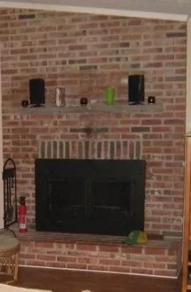

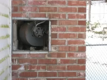

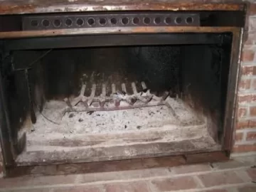

Newbie here, I have been reading some posts and this place has a load of information. The make of the stove in the pictures attached is by "Elco", but have found no information about it.(Note: the damper plate chain is an add on after the original was replaced) I hear this stove is more than likely a prefab, in a masonry chimney with a 8" square clay liner. The house butts right next to the chimney, built in the late 80's. I wanted to try and see how it was built in and took the face plate off. I was hoping I could just put an wood insert in, but looks like my options maybe limited. I was reading in another post about the kozy heat z42 option. I'm curious what my options are, if anyone has taken one of these out completely (if possible) or modified it a way so that another, more efficient, stove can be put in. The size of this stove opening is 44" wide by 30" tall. I want to run the stove 24/7 to heat a 2,000 sqft area, or the biggest stove I can fit in there so it doesn't look stupid. Thanks for the help!

I had a chance to look at it in person, this thing is something fierce. The firebox is HUGE. There must be 700+ pounds of welded steel to make this contraption. It looked like he might be able to do some cutting until an insert could be installed. There are tubes that run outside air through the flue area to heat it and blow into the room that would get in the way of a liner. There doesn't seem to be anything combustible in the area. This whole thing is steel inside a real masonry fireplace/chimney.

Have you looked into having an insert installed with a liner? What's the opening size without the doors? What is the depth?
I have thought about it, but thought for the long run removing it and building a firebox would be better to accomodate a larger insert. The largest area withought removing too much would be 24" high by 39" wide. I also want to make sure there is no combustible materials anywhere in there to make myself feel better.
Seems like a lot of work. I'm not a mason, but one concern would be whether this could be done safely. Also concerned about structurally supporting the load during construction. If you can find an insert you like and put in a liner, I would not worry too much about combustibles. The heat will be isolated much better with this arrangement.
Based on those dimensions you can put in a nice sized insert (missing depth dimensions). How large an area is getting heated here?
I am with BG on this one. If you can, leave the box there and slide in an insert with new full liner .
I left my old Heatform in, cut the damper are out enough to run a liner damn near straight on, and put a nice big Summit in there.
Much easier with minimal demo.
