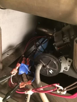

Today, I tested the vacuum switch with the blow-method.
It tested fine(click check)
I took the intake blower off, and blew it out real good: also checked the exhaust flue for obstruction,
Also made sure the over-temp wasn't tripped.
Re-connected wires going to vacuum switch, blowers, board...to ensure connection.
I was going to test for the 5VDC +\- to the vacuum switch, so put meter leads on it, plugged stove in, and the GREEN light came on for about 2 seconds, then the stove shut off completely...no lights, no button operation..
Unplugging - re-plugging would only serve to reset & it would do it again.
I thought perhaps either the vacuum switch needed to be screwed onto the body for grounding...maybe? and/or the door needs to be on the unit for some reason...Soooo, put switch back in place, removed meter leads, put left door back on, and the stove did the SAME thing I just described: and that's the state it's in.
I tried letting it sit for a good 45 minutes, but no help.
I am beginning to suspect the control board might be toast...

Started using it in the fall this year, bought good pellets, it noticed seemed to need
...coaxing: meaning, it would shut off after developing a fire, and burning down the pellets in the burn pot.
I would need to unplug/re-plug to get it going again...It also would show a flashing light, either #2 or #3
It seemed to be quite finicky as to when it would maintain a fire.
I took off the exhaust blower, cleaned things up & replaced the gasket.
I gave it a good general cleaning..but didn't seem to help.
It almost seems to have gradually gone downhill: needing more & more 'restarts' to get it going.
Over the past few weeks, it will not maintain a fire at all: We'll start it, it will feed pellets, light them, burn a bright fire, blower fires up...then flashing lights begin & it's dead until we unplug/re-plug.
Thoughts fellas?
Rich
