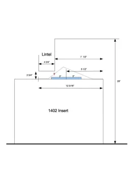

I really want to get the Napoleon 1402. My folks have had similar model for 10 years and love it. Seems like it really cranks out the heat. My problem is the lintel. The height is not great. It's 22 3/4" and the minimum for the 1402 is 22". So I got a little wiggle room. The height of the insert is really 20" so there is 2 3/4" gap. The real issue is the depth (or thickness) of the lintel. It is 4 3/4" thick. So basically the 6" flue opening is 1" under the lintel. It will be very tight and I will need to use the low clearance connector. EPA335KT.
Does anybody have dimensions of the part? I tried looking online and could not find anything.
I'm wondering if the connector will have enough room as it slopes up. It seems like it would but just barely. Attached is PDF showing the layout.
Thanks.

I don't have the specs, but can see how this could be a squeaker. If this solution doesn't work out for you, there are very good inserts in this size that have the flue collar set further back. A couple examples would be the Regency 2400i and the PE Pacific insert.

I finally got some specs on this part. This will come off the top of the unit at a 30 degree angle instead of straight up. The piece alone sticks up 4-1/2" total at its high point.
